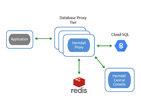

The Heimdall proxy is a transparent data access layer that intelligently routes queries to the most optimal data source, resulting in SQL offload and improved response times. The proxy determines whether to retrieve the SQL results from cache or the backend database. If a read query is not deemed cachable, the proxy knows which database instance should be accessed. This architecture is particularly useful for users of Postgres, MySQL, and SQL Server.
Figure 1: Heimdall Proxy Architecture

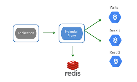

When horizontally scaling out Cloud SQL, developers often encounter data synchronization issues. There’s a time lag when data was written and when the read replicas are updated. The Heimdall proxy routes queries to the appropriate database instance by accounting for replication lag and transactional state.
There are a variety of approaches to Read/Write splitting, but they are not replication lag aware. That is, how do you know when the WRITE has been updated across all database instances? Could you be reading stale data? Other solutions may track the replication lag but are not intelligent enough to determine WHEN it is safe for a particular query to be routed to the read-slave.
Note: The Heimdall Proxy does not support data replication; that is the job of the database. Our proxy detects when data has completed replication and routes queries to the appropriate database instance.
The proxy parses each query to determine what tables are associated with it. The last write time to the table is tracked; as well as the time it took for the update to appear on the read instance. With this information, the proxy determines which database instance is “safe” to read from–either the read instance or only the write/primary instance.

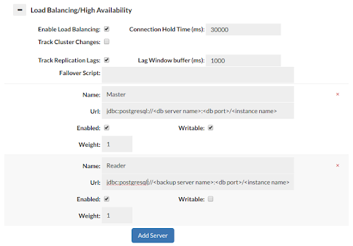

After completing the Wizard, the configuration will be pre-populated. The “Data Sources” tab should appear like below, with one read/write instance configured along with at least one read-only instance. Ensure that a read/write primary is configured with at least one read-only instance:
In Figure 3, the replication lag was set to 1000ms. Here’s how it would work:

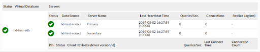

The value of the detected replication lag is found on the Status screen (if any):

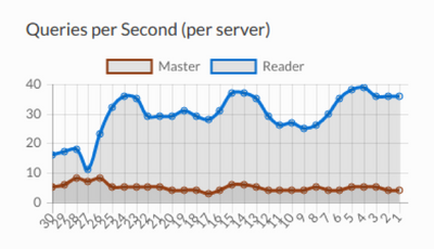

Real-time analytic charts on the Analytics tab shows read and write queries now splitting:
On the Analytics tab of the central console, the dashboard below shows that Read/Write splitting is now occurring, rerouting read traffic from the primary to the read replicas. The majority of traffic is now routed to the read replicas. It works!
