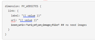

Hello!
I am trying to add a clickable link dimension into a LookML .view, and from https://cloud.google.com/looker/docs/reference/param-field-link I could roughly understand how to create dimensions that results in clickable links.
However, I am using tables already exists as url in the rows themselves, the table contents are basically:
MY_WEBSITES
www.abc.com/11
www.abc.com/22
www.abc.com/33
Am I correct to assume that I could simply use the same liquid variable for both "label" and "url"? I just need to display the table results as the url themselves, which are clickable. Eg:
^For some reason it doesn't let me post if I include the curly brackets in the code, so attaching as image.
Haven't been able to find any other articles or documentation that fits my situation, thanks in advance!
0 4 715
Ah re-reading a bit more of your post, yes I think the only thing you would need is: url: "(( value ))" since it is already a URL from your database!
*please replace the parentheses with curly brackets - I had the same issue with posting!
Awesome! thank you Amanda
