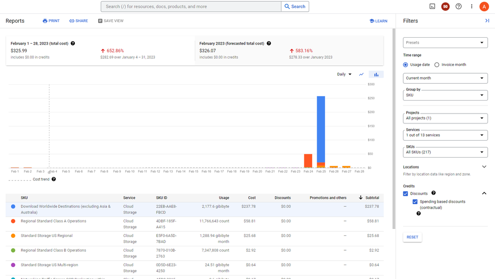

Thanks so much for always responding so quickly, kolban! Looking at the report, things are starting to make more sense (screenshot of the report attached below). So after I finished running everything I wanted to in Cloud Run, I downloaded about 2.1 TB of the data to my local machine. That has to be what the Download Worldwide Destinations (excluding Asia & Australia) refers to. Copying of data from a Cloud Run service to a bucket shouldn't be involved with this SKU, right?  Even the usage matches up with around the amount I downloaded to my local machine (the report shows 2,177.6 gibibyte, which lines up with the 2.1 TB I copied over) but isn't this considered more of an egress fee? I didn't know that downloading data from a bucket to a local machine costs this much money. EDIT: I found documentation on this particular SKU here.  Am I correct when I say that this charge was due to downloading data from the bucket to my local machine?

When I look at the pricing docs ... I seem to see that moving data within the same region is free.  So if your bucket were in us-central1 and your Cloud Run were in us-central1 there should be no charge.  However, there are charges if your permutations are other ... for example a Cloud Storage bucket located in a US Multi Region and your Cloud Run were located in a different region.
We see the list pricing by looking up the SKU here.   The prices seem to apply to "General Network Usage" ... which is where you are egressing Cloud Bucket storage over the Internet.
Your Regional Standard Class A operations seems a lot. 11.7 million class A operations.   28 days = 28 * 24 * 60 * 60 seconds = 2.4M seconds.   That is approx 4.9 operations per second CONSTANTLY.   The prices match ... 11.7M class A at $0.005/1000 does equal $58.
