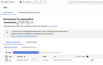

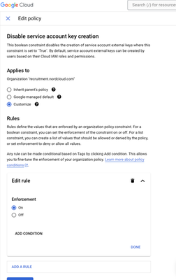

Hello @Jacobees ,
1. Pick your user. I've created user named "test test" for this demo.
2. Add your newly created user to Super Admin role OR be sure that you user is in that group. Log in to admin.google.com -> Account-> Admin roles -> Super Admin
3. Go to https://console.cloud.google.com and log in with your SUperUser from step1.
4. From left top right corner pick project list and search for your organization
5. Search for IAM -> Grant Access -> Add your SuperUser in "New principals" field. Select either Organization Admin or Organization Policy Administrator to be able to deal with org policies.
6. Click "SAVE"
7. You can verify your changes. Once saved, wait few minutes to be sure that IAM have been properly propagated.
Add1. You can verify your permissions by using Policy Analyzer -> What access does my employee ( or terminated employee ) have -> Create query -> Put email name for your SuperUser in "Principal" field -> Continue -> Check boxes (
List resources within resource(s) matvhing your query and List permissions inside roles )
cheers,
DamianS
Hi Damian S,
Thank you for the  effort you went to providing me with this information. I was able to successfully follow these steps and create the key.
My issue was I had added the Organization Administrator role but did not have the Organization Policy Administrator added.
Cheers,
Jake.

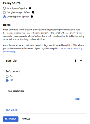

I have a fix that works for me - hopefully it will work for all.

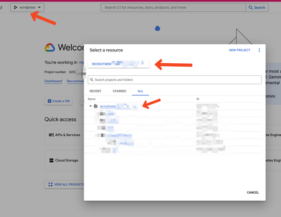

1. Click the down arrow
2. Select the organization level
3. From the "Burger" menu select [IAM & Admin] > IAM

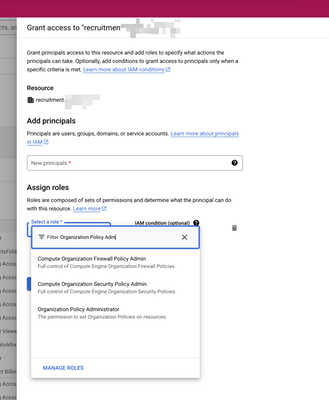

4. Click [Grant Access]
5. In [New Principals] Enter the account you are currently logged in with
6. In the [Role] select Organization Policy Administrator.
7. In the [Role] selector there is a filter that can be used to make this selection easier.
8. Click [SAVE]
9. Refer to step 1 and switch the focus back to the project you created.
10. From the "Burger" menu select [IAM & Admin] > [Organization policies]
11. From the list of organisational policies select [ Disable service account key creation] - this is on the 2nd page of policies.
12. On the policy page click [Manage Policy]
13. Select [Override] parent's policy]
14. Add a rule and set enforcement off
15. Click [Set Policy]
16. Logout and back in to the developer console
I was then able to continue to continue to create the Service account keys

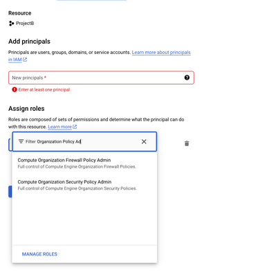

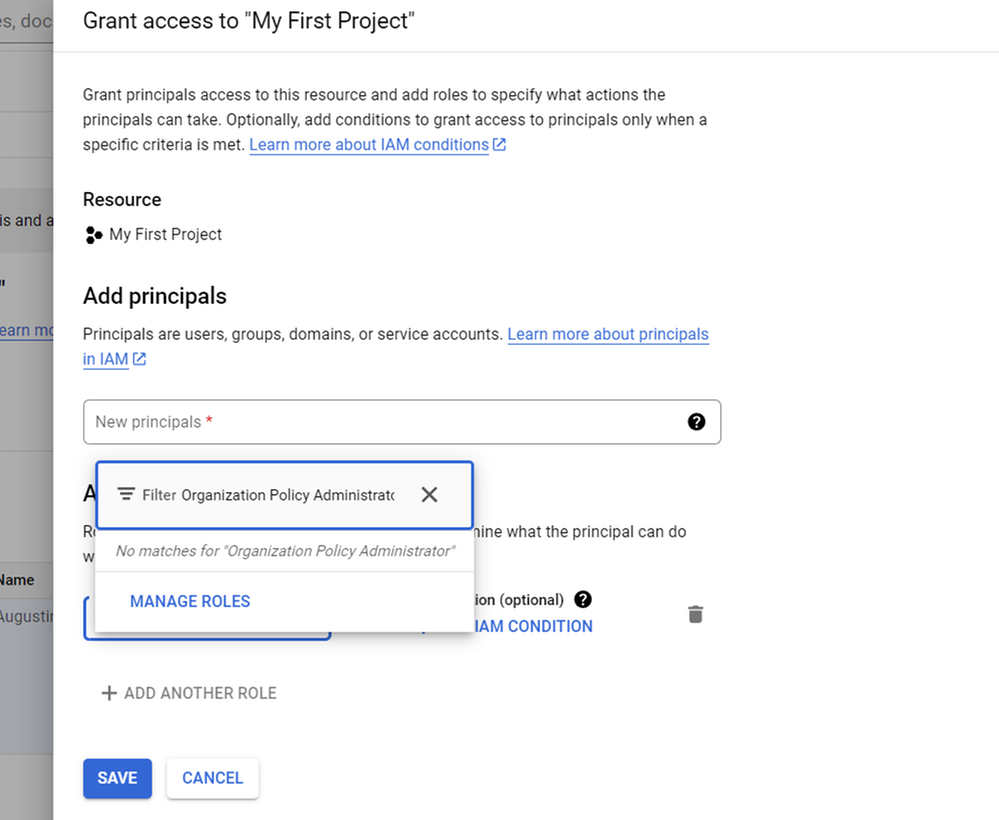

I am unable to find "Organization Policy Administrator" role
@riyoutku ,
This policy can be assigned ONLY at organization level. You are showing project level on the screenshot, and this is why you are not able to see mentioned policy
cheers,
DamianS
