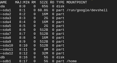

This is the disk after I increased from 10G to 25G, not to sure about the details in the in the screen shot because it reads 60G.
sudo df -T
sudo lsblk
From the information provided, it is strange that your VM shows a larger disk than what you have configured. You could report this issue on issue tracker. Also you should reach the Support team for further assistance.
