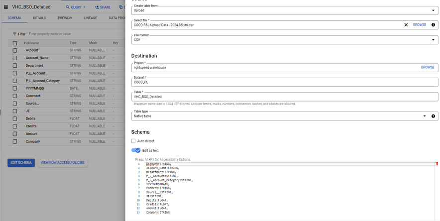

I found the error.
The column headers of the csv file I upload contain spaces.
i.e. one of the column headers in the csv is 'Completed Date'.
In the past, BigQuery would upload this as Field Name = Completed_Date. Anytime I would upload a csv file, the header would remain the same ('Completed Date') and would go through without any issues.
Something must have changed since June 3 (last time I uploaded any csv files), as now, BigQuery uploads the same Field without the underscore hence the error I get (which sucks to get as an error as it doesn't explain what is a very simple error).
The field name is now 'Completed Date'.
See screenshot below, on the left is the schema and field names the way they would get uploaded. On the right, is how it shows and where the column headers from csv files now have to match 100% field names.
