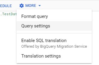

Just in case someone stubbles upon this problem the solution is to  set the Appropriate Location Type inside the Query Settings before Executing the query.
This worked, thank you so much 😊
