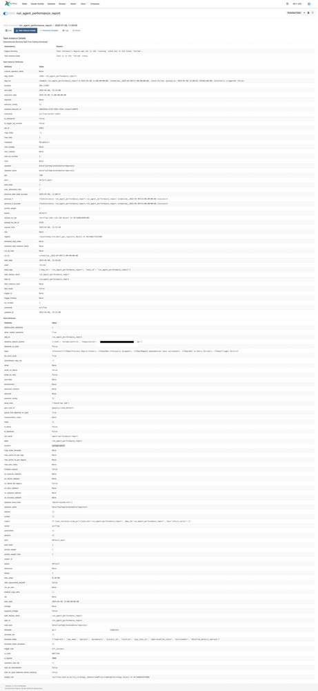

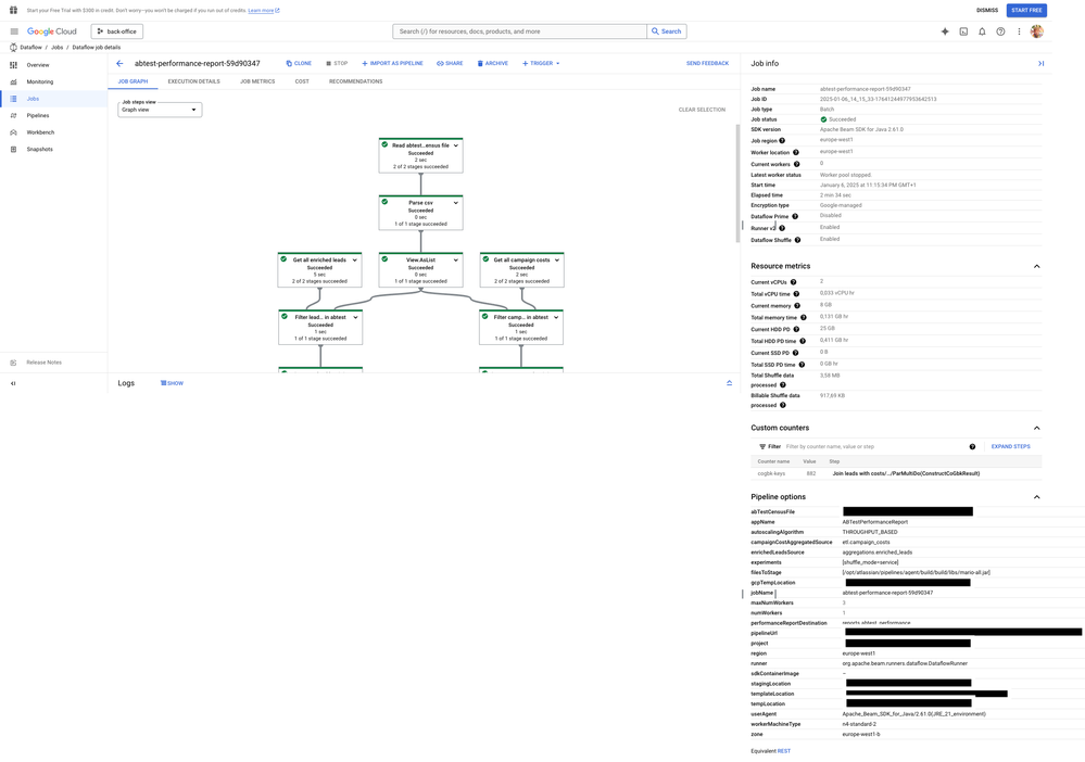

We recently migrated from Cloud Composer 1 to Cloud Composer 2 but we have issues when Composer tries to check the DataFlow job status.
Dataflow correctly starts but often, the Composer worker seems to be unable to check job status, here are some screenshots for an example (but this issue happens with almost all our flows)
screencapture-61295dff005c4e0e862ecfdccf276783-dot-europe-west1-composer-googleusercontent-task-2025-01-07-10_11_20.pngscreencapture-console-cloud-google-dataflow-jobs-europe-west1-2025-01-06-14-15-33-17641244977953642513-graphView-0-2025-01-07-10_12_35.png

thanks a lot
sorry are the logs helpful? The issue is still there, dataflow job ends correctly (in dataflow jobs report is marked as successful ) but arflow reports it as unresponsive, sometimes, it seems that airflow does not even try to check for the job state. The DAG just "hang"...
any help please? We are stuck in this issue, some of our data started to be not so reliable due to this issue
The formatting of the text of the logs isn't easy to read in the forum format.  My thinking on looking at the logs was to try and get deeper into the underlying problem.  If this issue is critical, you may want to consider raising a formal support case with Google Support.  Either that or search on the Apache Airflow sites using the relevant log records as key word searches.  I don't think this forum is a replacement for general support but rather an attempt to try and resolve specific and focused questions and also put similar minded folks together.
