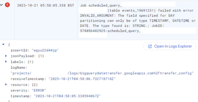

Thank you so much again, @ms4446 Does this mean delete , insert statements are not required in the scheduled query?
-- delete
-- `my_project_id.ga4_master.a_table_name`
-- where
-- event_date = FORMAT_DATE('%Y%m%d', DATE_SUB(@run_date, INTERVAL 1 DAY)); --date_sub(@run_date, interval 1 day);
-- insert into
SELECT
  event_date,
  event_timestamp,
  event_name,
  event_bundle_sequence_id,
  user_id,
  user_pseudo_id,
FROM ...
WHERE...
 and the destination table id sets to events_{run_time-24h|"%Y%m%d"} ?
Yes, if you use the overwrite option with the destination table ID set to events_{run_time-24h|"%Y%m%d"}, you won't need the delete and insert statements. The overwrite option will ensure that the data in the specified table is replaced with the new data from the query each time it runs. This simplifies your query to just the SELECT statement along with its FROM and WHERE clauses, making your scheduled query more straightforward.

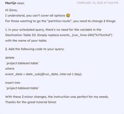

i'm not sure what this 2 posts trying to achieve? in https://www.teamsimmer.com/2022/12/07/how-do-i-trigger-a-scheduled-query-when-the-ga4-daily-export-h...

 I have to wait until the next ga4 raw event table created and if the function works at my time which is tomorrow.   Thanks for your time ms4446.
It looks like the cloud function is working. However, i got an error in scheduled query history:
I removed the partitioning field in scheduled query setting and retry the query.  The table events_19691231 was created.  I think i need to specify the partitioning field to a field which has type TIMESTAMP, DATETIME or DATE but not string.
Here's the GA4 raw data tables
The destination table in ga4_master dataset should be events_20231020. How do i fix it? thanks
