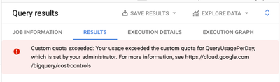

I’ve encountered an issue where the quota usage exceeds the quota limit.
From Big Query APIFrom Big Query API
I’ve already reviewed all configurations, and everything seems to be in order according to standard settings.
After exceeds I cannot do query again (as expected).
Query exceed the limit after exceeds 2 MB.Query exceed the limit after exceeds 2 MB.

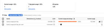

 As I understand from the documentation, the quota limit for QueryUsagePerDay is the number of bytes that can be processed by queries, so the current usage should be equal to or lower than the quota limit. However, in my case, the current usage is 102MB while the quota limit is 100MB, so it is exceeding 2MB.
To reproduce the issue, I followed these steps:
  1. I changed the quota usage per day from unlimited to 100MB.
  2. I ran some queries until I could no longer run anymore because I had exceeded the custom quota for QueryUsagePerDay. [1]
  3. I checked the current usage for QueryUsagePerDay in the BigQuery API, and it showed 102MB when my custom quota is 100MB. [2]
So, I am not saying that I don’t believe that the quota should not have been exceeded, but I am curious to know why the current usage can exceed 2MB over the quota limit.
As it is shown in Big Query API that current usage > 2MB than QuotaUsagePerDay Limit

The situation you're describing, where the current usage exceeds the set quota limit, could be due to a few factors:
  1. Query Completion Time: If you ran a query that started before the quota was reached and it completed after the quota was exceeded, the total bytes processed by that query might push the usage over the limit. BigQuery processes queries atomically, meaning that if a query starts, it will complete even if it pushes you over your quota.
  2. Delayed Reporting: There could be a delay in the reporting of the quota usage. This means that some queries that were executed just before the limit was reached might only be reported after the limit has been exceeded.
  3. Quota Calculation Method: The way BigQuery calculates quota usage might not be straightforward. It could include additional factors like the data processed by query execution plans or other internal metrics.
  4. Caching: BigQuery does not charge for queries that return cached results, but it's possible that if the cache expires and the query re-runs, it could contribute to the quota unexpectedly.
  5. Background Processes: There might be background processes or automated scripts that are running queries on your behalf which you might not have accounted for.
  6. Billing Cycle Alignment: The quota usage might not align perfectly with the billing cycle, especially if changes to quotas are made mid-cycle.
If you consistently see that the usage exceeds the quota by a small margin and it's causing issues, you might want to set a slightly lower quota to create a buffer or reach out to Google Cloud Support for a more detailed explanation of how the quota usage is calculated and reported.
