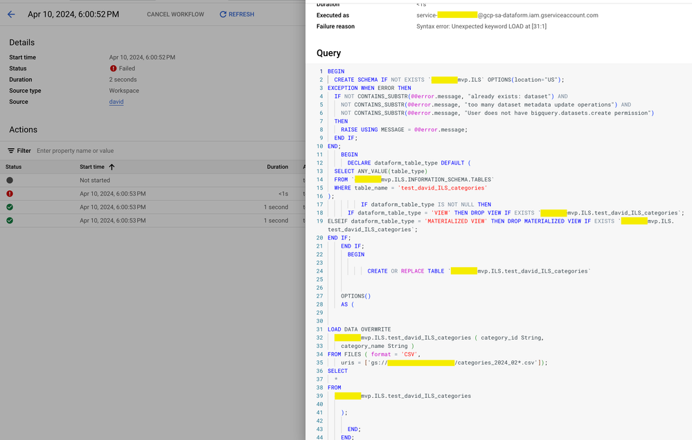

In the details of the workflow, I'm getting this error: Syntax error: Unexpected keyword LOAD at [31:1]
BEGIN
  CREATE SCHEMA IF NOT EXISTS `[MY_PROJECT].ILS` OPTIONS(location="US");
EXCEPTION WHEN ERROR THEN
  IF NOT CONTAINS_SUBSTR(@@error.message, "already exists: dataset") AND
    NOT CONTAINS_SUBSTR(@@error.message, "too many dataset metadata update operations") AND
    NOT CONTAINS_SUBSTR(@@error.message, "User does not have bigquery.datasets.create permission")
  THEN
    RAISE USING MESSAGE = @@error.message;
  END IF;
END;
    BEGIN
      DECLARE dataform_table_type DEFAULT (
  SELECT ANY_VALUE(table_type)
  FROM `[MY_PROJECT].ILS.INFORMATION_SCHEMA.TABLES`
  WHERE table_name = 'test_david_ILS_categories'
          IF dataform_table_type IS NOT NULL THEN
      IF dataform_table_type = 'VIEW' THEN DROP VIEW IF EXISTS `[MY_PROJECT].ILS.test_david_ILS_categories`;
ELSEIF dataform_table_type = 'MATERIALIZED VIEW' THEN DROP MATERIALIZED VIEW IF EXISTS `[MY_PROJECT].ILS.test_david_ILS_categories`;
END IF;
    END IF;
      BEGIN
            CREATE OR REPLACE TABLE `[MY_PROJECT].ILS.test_david_ILS_categories`
    OPTIONS(description='''A table description here''')
    AS (
LOAD DATA OVERWRITE
  [MY_PROJECT].ILS.test_david_ILS_categories ( category_id String,
    category_name String )
FROM FILES ( format = 'CSV',
    uris = ['gs://[PROJECT_WITH_SOURCE_DATA]/categories_2024_02*.csv']);
SELECT
FROM
      END;
    END;
I suppose that Stored Procedure was expecting a SELECT statement. Is there a way to accomplish the table creation from a CSV directly from Dataform?

See the documentation, you should use `operations` type in the config block (with hasOutput=true). Or you could keep `table` and wrap the LOAD statement in the `pre_operations` block.
I just figure that out, but thanks for your answer. The operations type did the trick!
