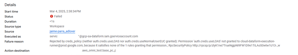

I'm trying configuring an external table using the operators but when we try to execute, I get the following error.

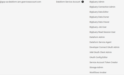

We did enough roles to the Service agent but it continues failing.
The AWS region we are configuring is "aws-east-1". Also when we copy and execute the query generated by Dataform in the bigquery console it works well.

1. If we run a process where the region is US, us-east1, the materialization of the views or tables works without incident.
2. If we want to create an external table or view in aws, even if we define the aws-us-east-1 region in the configuration file, it fails due to the error shared in the image.
3. The bigquery omni permissions are correct because the users (including me) can read the sources and create them from the console without problem.
The conclusion is that it is the dataform service that does not work when we do an execution process inside the service.
Finally, at the permissions level, even the dataform service agent was given Owner permissions on the project and it still failed. Although I reiterate that it only happens when you are going to create an external table in the omni aws dataset, in the other cases it works normally.

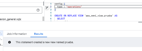

Additionally, when executing queries from Workspace, external tables in BigQuery Omni are successfully created, and we were able to deploy some views by adjusting the YAML configuration with location=aws-us-east-1.
Here’s an example of a view that we tested and confirmed to be working correctly:
prueba.sqlx
config {
    type: "operations"
CREATE OR REPLACE VIEW
  `aws_omni_view.prueba` AS
SELECT
  REGEXP_EXTRACT(_FILE_NAME, r'/([^/]+)/[^/]+\.parquet$') AS subfolder,
  PARSE_DATE('%Y%m%d', REGEXP_EXTRACT(_FILE_NAME, r'\d{8}')) AS partition_date
FROM
  `aws_omni_campanas.prueba`
We also confirmed that executions from the BigQuery Console run correctly and that data is created in the expected region (aws-us-east-1).
Furthermore, when reviewing BigQuery Job History, we observed that manual executions from Workspace are indeed running in the configured region (aws-us-east-1), indicating that the YAML settings are being applied correctly within the Workspace environment.

Even though executions from Workspace behave as expected, when we schedule a Dataform execution, we receive an error.
