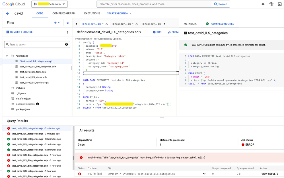

This part:
config { ... database: "Project2",
schema: "Dataset2" }
Is not working:
This is my dataform.json file:

There are a couple of things to address in your example to make your SQLX file correctly write to the intended project and dataset:
1. Typos and Syntax:
  • Dataset Name: Be meticulous about the table name (test_david_ILS_categories) – ensure it's spelled correctly and used consistently throughout your files.
  • Database and Schema Placement: The database (for project ID) and schema (for dataset ID) should reside within the config block and be correctly indented.
2. Project and Dataset Targeting:
  • Configuration Alignment: Your dataform.json looks correct, setting the default database to "mvp". Make sure your SQLX file's configuration aligns with this.
Key Points:
  • Indentation: YAML syntax (used in the config block) relies on proper indentation. Check that your configuration is correctly structured.
  • Consistency: Mismatched table names lead to errors. Maintain consistency throughout your code and configuration.
  • Database and Schema: The database targets the project, and schema targets the dataset. Ensure you've specified these correctly.
Important Note on Data Loading:
  • Dataform's Focus: Dataform is primarily designed for transforming data that is already within BigQuery. It doesn't directly support commands like LOAD DATA OVERWRITE.
  • Loading Tools: To get data from CSV files into BigQuery, use tools like:
    • BigQuery UI (for simple uploads)
    • bq command-line tool (for automation and scripting)
    • BigQuery API (for integration with other applications)
Example using bq:
bq load --source_format=CSV --autodetect \
mvp.ILS.test_david_ILS_categories \
gs://data_model_generator/categories_2024_02*.csv
