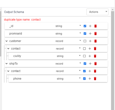

I'm trying to read data from MongoDB and send it to a BigQuery sink.
I'm having issues reading the data because I have duplicate name records in different nodes (same problem when I have the same field name) see the pictures attached
Anyone who has experienced this problem and resolve it?
Thank you

Is rename transform a component (didn't find it in hub)? or you mean rename the field in mongoDb input ?

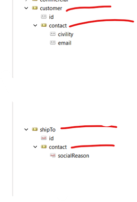

what should i do in case of 2 record with the same name ( see picture 1  customer.contact and shipTo.contact ) i've tried to rename in mongodb input but i have 0 output.

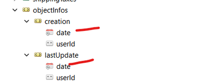

i've tried a lot of syntaxe possibility in mongodb input query but still have no output on my renamed field, note that when i try my query in mongodb client ( studio 3T / robot ) it works fine see picture ( in blue old field name in orange new field name ).
here is an exemple of a query :
"$or": [
"objectInfos.creation.date": {
"$gte": {
"$date": "2023-08-04T00:11:16.847Z"
"objectInfos.lastUpdate.date": {
"$gte": {
"objectInfos.lastModification.date": {
"$gte": {
"$addFields": {
"shipTo.contact2": "$shipTo.contact"
can you correct ? or give me exemple of how i should write it in mongodb input query
