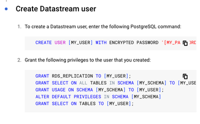

Let me share the steps I did. I followed the instructions provided on screen while creating datastream
1. While creating the source I choose postgres to bigquery and followed the settings mentioned here.

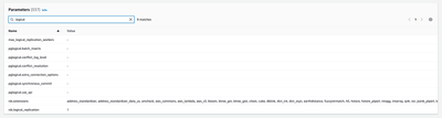

2. I just enabled rds.logical_replication to 1 and restarted the DB. Rest are default configurations
3. Below is the wal parameter values
4. Publication and slot were created
5. In the datasteam user setup, I used an existing user.kabilanravi_2-1694152589405.png
So I did only the step 2.
6. I used ssh tunneling to connect to the RDS which is inside VPC. Whitelisted the ips in the security group.
7. I selected only 2 tables from the schema while doing the stream operation.
