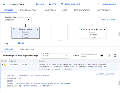

I tried the following to trouble shoot but still there is no data in the final table
1. I changed the merge frequency minutes to 0
2. Data flow has all the permissions as it created a table
3. The final table schema is same as staging table schema
4. there is no data in the dead letter table as well
5.all the parameters are configured correctly
and
the datastream is runnig and there is no errors in dataflow logs as well .
this is the info i got in the dataflow log
so what else can I do?
This is the warning message I got in the bigquery merge step, so is it necessary to have a primary key in my source table (my source table is a Mysql database which is configured to the datastream ) to perform merge operation?

Warning message:
The warning message you provided indicates that BigQuery is unable to retrieve the primary keys for the table Admin.Patient_Table in the stream projects/715481357886/locations/us-central1/streams/akumin-streaming. This is likely because the table does not have a primary key defined.
Resolution:
To resolve this issue, you can either:
  • Add a primary key to the table Admin.Patient_Table in the MySQL database.

A primary key is not strictly necessary to perform a merge operation in BigQuery, but it is highly recommended. Without a primary key, BigQuery will use a combination of all columns in the table to determine which rows to update and which rows to insert. This can be inefficient and can lead to unexpected results.
