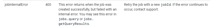

We had a reply from Google Cloud Support :
The BigQuery Engineering Team shared that your failed job was affected by a spike in traffic which caused system overload in a short period of time.
With this, they have suggested you rerun the job and advise if the same error still appears at your end.
So the only way to keep running the connector instead of failing when this error happen is to modify the kafka connector code to retry job when this error happen

Thanks for your detailled answer !
Yes, that's the problem with this error, it's a broad error and it's hard to know what happened. The Bigquery connector does not seems to catch this error as a Retryable error so it automatically fail and require manual restart
I don't think it's Data issue since the connector should not skip data, but it could be network issues, we already had problem with another connector because of network error, we fixed it but I think we can investigate more on this.
Check LogsWe checked log already and we have no more information except this BigQueryException, and it the other request that were running at the same time (since batch merge happen every 5 mins) didn't failed
Monitor Resources:  We do not see any special resource usage during this problem with our monitoring system, we will continue to monitor it maybe we will find something
GCP Operations Suite:  Seems that something is missing to use this monitoring tool since I don't see much logs in logs explorer I will check with my team
On the Other hand someone told me that we took the Cloud Support service since few month so I can also check with google assistance if they have more detail on their side
