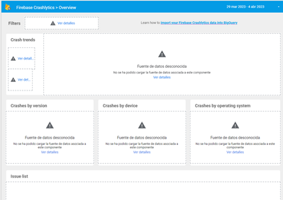

Hi everyone,
I am successfully exporting my Crashlytics data to BigQuery, and tried to export it to the provided Looker Studio template in the documentation. (https://lookerstudio.google.com/u/0/reporting/10TMAKxL0ZxcNGTLDQy1LAF5V7uNDYxRC/page/1xZU/preview?hl...)
The issue is, when selecting 'use my own data' and my crashlytics table, (selecting default), i get all errors and no data is displayed, like this:
Where I get all 'Unknown data source' messages. How can I use the template?
Thanks in advance,
Unai

Hi Aris_0,
I am not having any trouble with NSErrors or data transfers. As I said, my data transfers work fine and I get all the data in BigQuery.
The problem is that when using the Crashlytics template in Looker Studio, when selecting 'use my own data' and my crashlytics table, (selecting default), i get all errors and no data is displayed, in all the graphics I get 'Unknown data source' messages. How can I use the template?
I'm also getting same error. The data exports are working correctly and I can even query the data, but report doesn't work.
I am getting this problem too - I have successfully linked Firebase Crashlytics to BigQuery and can query live data. But when I try to link the BigQuery tables to Looker, it seems to link and then I get the same errors as you are seeing where it cannot find the data source.
Really frustrating! I've tried setting up additional replicas in case it was geo-location problem but I cannot seem to make Looker work with Crashlytics tables - however it does work fine with Firebase linked analytics tables! Go figure.
