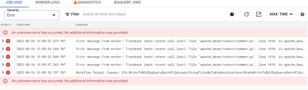

I'm using a basic ETL pipeline to run in dataflow. Python script is in my default cloud shell VM from where I'm running it. I have defined the arguments as mentioned below,
python3 my_pipeline.py --project centon-data-pim-dev --region us-central1 --stagingLocation gs://sample_practice_hrp/staging --tempLocation gs://sample_practice_hrp/temp --runner DataflowRunner
link to the sample file used,
https://github.com/GoogleCloudPlatform/training-data-analyst/blob/master/quests/dataflow_python/1_Ba...
while the other options are as below,
    input = 'gs://sample_practice_hrp/events.json'.format(opts.project)
    output = '{0}:logs.logs'.format(opts.project)
Unfortunately, I'm receiving some error, causing the pipeline to fail (picture attached)
1 3 2,681

From the errors you're seeing, it's not immediately clear what's causing the issue, as the traceback isn't complete and there's a repeating error message.
They are generic error messages that come from the Apache Beam Python SDK, and they indicate that an error occurred during the processing of elements by a DoFn function in the pipeline.
  1. The first error, "An unknown error has occurred. No additional information was provided," is a very general error and could be caused by a wide range of issues. Without additional details, it's hard to diagnose the problem.
  2. The second set of errors, which include the traceback "apache_beam/runners/common.py, line 1418, in apache_beam.runners.worker.operations.DoOperation.process", indicate that an error occurred during the processing of elements in a DoFn function. DoFn is a fundamental concept in Apache Beam representing a "Do Function", which is where element-wise operations are defined. However, without the full traceback or error message, it's hard to tell exactly what went wrong.
  3. The final error message, "Workflow failed. Causes: S16:WriteToBQ/BigQueryBatchFileLoads/GroupFilesByTableDestinations/Read+WriteToBQ/BigQueryBatchFile", suggests that the error occurred during the step of writing to BigQuery. This could indicate a problem with the data being written, the schema of the BigQuery table, or the permissions of the service account used by Dataflow.

Thanks for your detailed response, I wanted to share further details by sharing the error logs.json file (unfortunately, I wasn't able to upload it here).
However, with a random guess I diagnosed the issue was with the dataset in which the table in BigQuery was supposed to be created and that was not created. I initially thought the code would generate the dataset itself (like the table it created), which it didn't.
