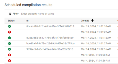

Hello, I have an issue in dataform in connection to my gitlab repository. The release configuration in Dataform fails which causes tables in Mongodb-prod to not update daily.
here is the error message
Any thoughts on this? It would be a great help
