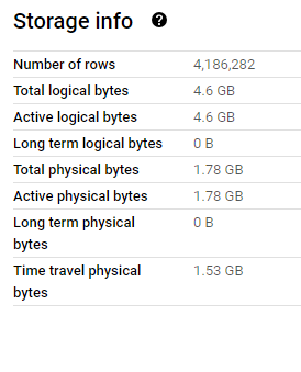

Here is the storage info of the table.
Could you please clarify?
Let me clarify. In BigQuery, when we refer to "files", it's typically in the context of how the data is physically stored on Google Cloud Storage. Each "file" is essentially a chunk of your table's data. These files are created and managed automatically by BigQuery and are not directly related to partitions.
The number of files can increase due to various factors such as the number of load jobs, query jobs, or copy jobs performed on the table. Each of these operations can create new files. Also, modifications to the table like updates or deletes can result in additional files.
In your case, since the table is not partitioned, the number of files is likely due to these types of operations. Unfortunately, BigQuery does not provide a direct way to control the number of files.
However, you can indirectly reduce the number of files by creating a new table from the existing one. When you create a new table based on a SELECT * query from the existing table, BigQuery will often consolidate the data into fewer files. Here's an example of how you might do this:
