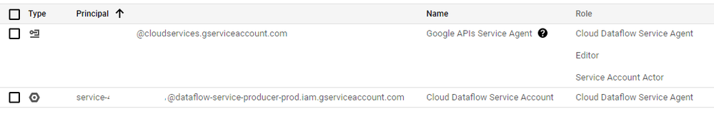

We have theses accounts:
Does anyone know how to add this cloudservices robot account?

Please check the following list:
  1. Check under APIs & Services to see if the Dataflow API is enabled. If you only enabled it, give it some time to update.
  2. There should be service accounts for [project-number]-compute@developer.gserviceaccount.com and service-[project-number]@dataflow-service-producer-prod.iam.gserviceaccount.com Contact dataflow support or build and assign a Cloud Dataflow Service Agent role if dataflow-service-producer-prod wasn't generated. Create a shared VPC in the host project if you're using one, then assign the Compute Network User role.
Quick possible solutions are:
  • Try again and get a fresh failed job id.
  • Try to disable and enable the dataflow API and see if it works.
