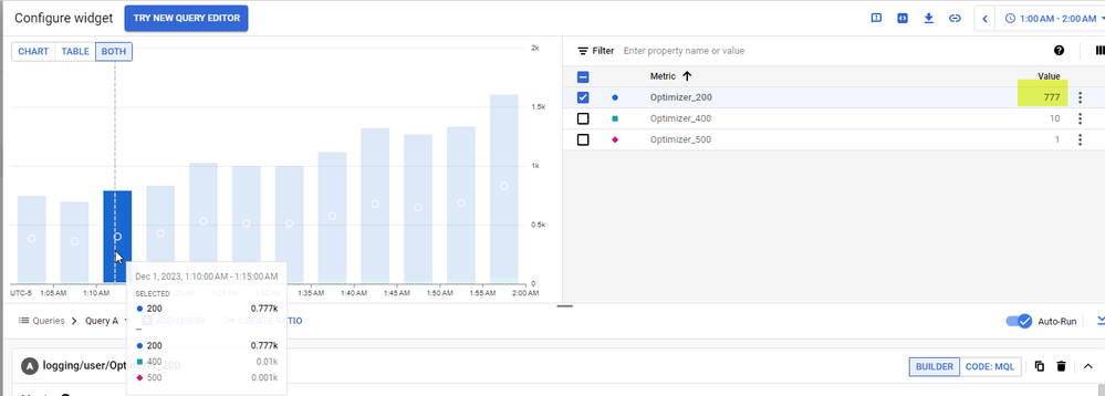

I have a log-based metric based on the query filter and used that metric to create the dashboard.  However, for certain time buckets the log entry number that is shown on the log explorer does not match what is shown on the chart.  How come the same query results in two different record counts for some time buckets?QueryUsedInLogBasedMetricCount.pngDashbordChartNumber.png

Thank you, @lawrencenelson for your prompt response.  Yes, I am aware of these reasons documented.  However, none of them are applicable here because of the following reasons:
  1. Since I am literally right clicking on the metric and chose View logs for metric option there is no way to have filter mismatch
  2. The metric was create a long time ago, so there is no question of needing to backfill of data
  3. if you look at the screen shot, Chart is showing more numbers than the Log Explorer for the same query as mentioned in bullet #1
  4. I am looking at the chart and logs after 12 hours they have been logged
  5. the metric is not a distribution but the counter type to observe how many times status code 200 has been logged during a certain time window
  6. Just to be clear this happens only for certain time windows and does not happen most of the time
I can understand if I used two different queries to validate the numbers but it is literally using the same query that is used by the metric which seems like a bug to me somewhere in the chart logic.
