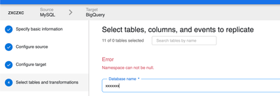

Hello friends, after updating Data Fusion to version 6.10.0, when creating or duplicating a replication task, I get an error (Namespace cannot be null.) and I can't do anything about it. What are the possible solutions to the problem?

I cant find anything about this error(
Recreate data fusion 6.9.2 version and all ok with imported task.
For me this was solution.
