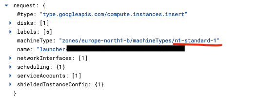

Okay, so we have done further troubleshooting and I believe it has to do with the machine-type.
We are not able to create a VM-instance with the n1-standard-1 machine type in europe-north1 due to resource exhaustion. However, we are able to create an n2-standard-2 machine type.
When I ran the word-count job, it was not able to create the VM-instance with n1-standard1 in either europe-north1 or europe-west3, independent of the zone I chose. But we could run the job with the n2-standard-2 machine-type.
When I'm trying to start the MongoDB-job and specifying the machine-type to either a custom machine or the n2-standard-2, the request still tries to create the n1-standard-1 machine. I have tried it both through the Cloud Shell and through the console. But neither of these ways are actually changing my request to start the machine-type I specified but is still trying to start the n1-standard-1.

This is the request in the logs for the VM-instance
I don't know if this is a bug with the MongoDB to BigQuery template or something else. But I've opened a Github-issue for it as well.
So after some digging around I found this in the terraform script for the template:
variable "launcher_machine_type" {
  type        = string
  description = "The machine type to use for launching the job. The default is n1-standard-1."
  default     = null
variable "machine_type" {
  type        = string
  description = "The machine type to use for the job."
  default     = null
The launcer_machine_type is a parameter I can't find a way of defining either in the Cloud Shell or in the console, and I would assume is the reason for the job to always default back to the n1-standard-1 machine type instead of the machine I'm specifying in the workerMachineType-parameter.
https://github.com/GoogleCloudPlatform/DataflowTemplates/blob/main/v2/mongodb-to-googlecloud/terrafo...
