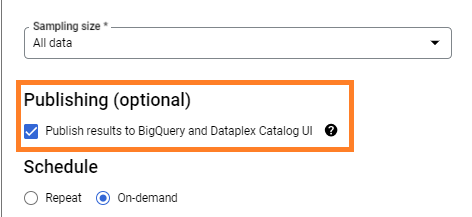

When I create a data scan in python, I want to publish it to the Dataplex Catalog UI interface at the same time. What should I do?

Thank you for your answer. I want to implement the operation of publishing to UI in Python code, as shown in the figure

Hey, I am also trying to create data profile scans using the dataplex library and want  to enable publishing to bigquery and catalog  ui.  Did you find a solution?
