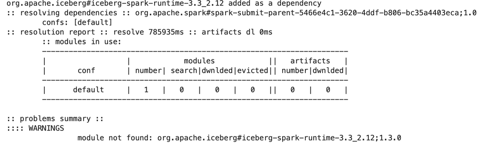

I am trying to install the iceberg dependencies in the dataproc clsuter where i am getting the module not found error.
spark-sql --packages org.apache.iceberg:iceberg-spark-runtime-3.3_2.12:1.3.0
steps taken:
  1. I tried tweaking the runtime version a lot of times and passing on repositories flag with maven central url as well

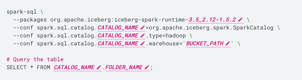

I want to primarily to be able to run the below code as stated in the official docs;

I was able to solve this by creating a public NAT gateway and then spinning up a dataproc cluster using that gateway.
The issue was dataproc was not able to access the internet to fetch dependencies and setting up NAT helped the case.
