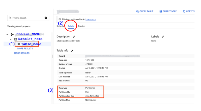

  2. The easiest way to check if the table is partitioned is by viewing by the Details tab, as illustrated in the image below. Alternatively, you can use INFORMATION_SCHEMA.PARTITIONS or INFORMATION_SCHEMA.COLUMNS, to gather information about partitioned and clustered tables or columns. For more details, you can also refer to this documentation. Please note that this may incur cost when running and requires the use of standard SQL syntax.
