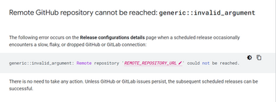

checked trouble shooting in Google Dataform docs: https://cloud.google.com/dataform/docs/troubleshooting#remote_github_repository_cannot_be_reached_ge...
So it could be dropped GitHub or GitLab connection. It said There is no need to take any action. Unless GitHub or GitLab issues persist, the subsequent scheduled releases can be successful.

Based on your error message in  the trouble shooting doc here https://cloud.google.com/dataform/docs/troubleshooting#remote-repository-invalid
No need to take any action.
