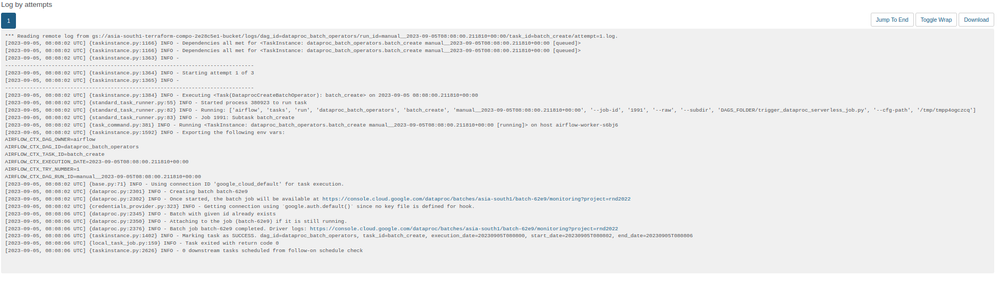

3. When I trigger my airflow dag it get successful but I not able to see my
dataproc job runs at gcp account. ( I am attaching airflow dags logs in
this mail)

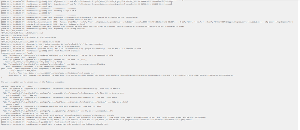

Hi @ms4446  thanks for explaining every concern so nicely.
I want to clarify some points for the first and last issue.
1. Do I need any type of cluster for Dataproc serverless job (batch jobs)?
  • When I trigger my airflow dag without any cluster it shows some error related to the phs cluster, after I create phs cluster and trigger the airflow dag. This time airflow was able to create a new batch job and trigger it successfully and the run count shown at gcp ui was one. ( I am attaching the airflow log file which shows the phs server error )
3. Airflow DAG triggers successfully but Dataproc job doesn't appear in GCP account:
  • I have permission, airflow dag is able to create batch jobs for the first time.
  • I have cross-verified all the details related to the region all are correct.
  • For the airflow logs, the composer is only providing me with these logs. If you need anything specific please guide me.
  • I am not writing any logic in airflow dag, I am just using airflow dag which I got from gcp official documentation. ( https://cloud.google.com/composer/docs/composer-2/run-dataproc-workloads )
One more query related to DataprocBatchOperator is that it is able to trigger existing batch jobs or not or what is behavior of this operator in a normal use case.
I am attaching airflow logs related to the first issue
Composer Logs - First ConcernComposer Logs - First ConcernLogs after job create - 2nd triggerLogs after job create - 2nd trigger
