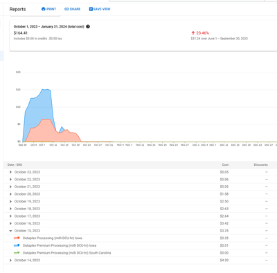

The last time I played with the system was on a Wednesday.  On Friday I got an alert that I had incurred one dollar worth of Dataplex charges.  I thought maybe there was a delay in some action I had done reaching the billing page.  Over the next 24 hours, I incurred an additional $3 worth of Dataplex charges.  I didn't even log into the system, so something is being automatically run to incur charges, but I cannot think of what it could be.

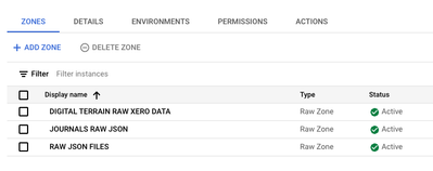

I checked my data lake, and I have 1 zone, with 3 assets in that zone. Each asset was configured for hourly data discovery. Each data discovery took < 10 minutes
If we multiply that out, we have 3 assets, 10 minutes per hour, 24 hours a day, 6 cents per hour.  That is 720 minutes, or 12 hours per day times 6 cents should be 72 cents per day. I had $3.95 in one day.
Am I misreading the logs about Discovery? Or are DCU's calculated differently than I am thinking?

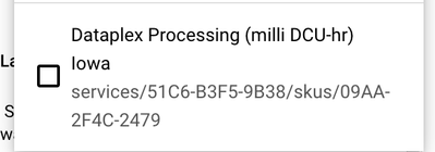

Well ... I have many projects that I use for sandbox testing and I seemed to remember I created one for playing with Dataplex.  Like you, I did NOT load in huge amounts of data, merely samples.  I looked back through my project history of spend and, just like you, I found charges of about $3-$4 a day.  Apparently, I switched something off (likely I deleted the project) ... but I can't remember for sure what I did.  The point of this post is to also share that you are not alone in having a consumption cost that neither of us can fully explain.  The SKU that I am seeing being charged for is: "Dataplex Processing (milli DCU-hr) Iowa".
I have the same issue, I have no idea why I'm using the premium processing instead of standard, and I couldn't find any place to switch or I tried to set up a new project and I'm not aware of anywhere to make the choice between premium and standard. It's terrible
