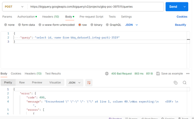

As  we have created table name with hyphen(-) , when we try to get data from it we are facing Bad Request (status code 400)  in POSTMAN  , Please help here.
Table name is  integ-parti-3519

If the table name contains special characters (which might include the "-" character) surround the name in back-ticks ... try:
select id, name from `bbq_dataset1.integ-parti-3519`
