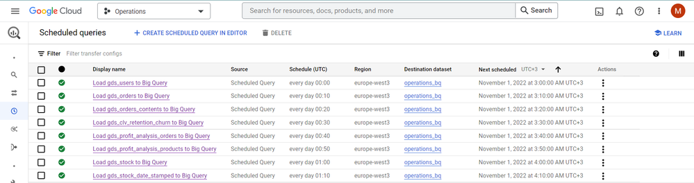

You are indeed! I just turned it off and all scheduled queries have run successfully.
