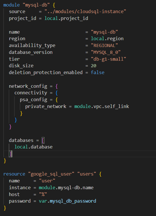

 With terraform I get the same error message, here is the code snippet:
I use Cloud Foundation Fabric modules in these snippets.

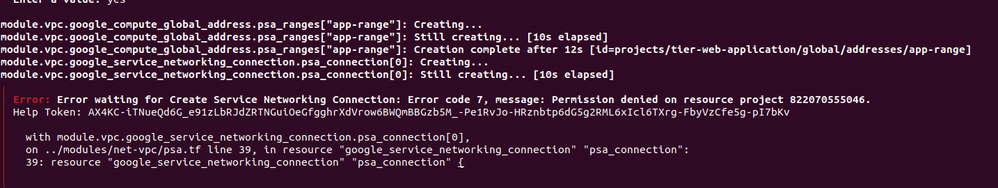

The error message when using Terraform:
As I mentioned, I have already deployed this project with Terraform with the same roles and everything went well. Have no idea why I get this error.

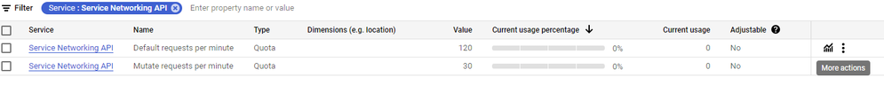

Thanks for the troubleshooting steps again. I followed your instructions and checked everything you mentioned. The issue is still not solved, BUT I have created a new project where I was able to set up a PSA without any problem! So more or less the issue is solved, but still have no idea what caused the problem. This is a side-project without organization and using the free trial usage.  Maybe it has some limitations, although the limits and quotas are not reached!
Thanks again for your help!  Your troubleshooting steps were very useful and instructive!
