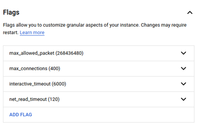

I tried to change flags to Cloud SQL instance:
I'm already without options left to debug this issue.

  1. When the client might be terminating the connection abruptly you could check for:
    If the MySQL client or mysqld server are receiving a packet bigger than max_allowed_packet bytes, or the client receiving a packet too large message,if it so you could send smaller packets or increase the max_allowed_packet flag value on both client and server. If there are transactions that are not being properly committed using both "begin" and "commit", there is the need to update the client application logic to properly commit the transaction.
