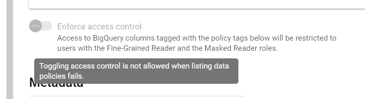

Hi, I am trying to enable the enforce to activate my policy tag, but it seams the toggle cannot be used, how can I use that?

The toggle is disabled because listing data policies is failing. This can happen for a few reasons:
  • There are no data policies in your project. If you haven’t created any data policies yet, there will be nothing to enforce. You can create a data policy by clicking the “Create data policy” button on the Policy Tags page.
  • You don’t have permission to list data policies. The user or service account you’re using must have the bigquery.dataPolicies.list permission. If you’re not sure whether you have this permission, you can ask a project owner or BigQuery administrator to grant it to you.
  • There’s a problem with the BigQuery API. If you’ve ruled out the other possibilities, it’s possible that there’s a problem with the BigQuery API. You can try contacting Google Cloud support for help.
Once you’ve fixed the underlying issue, you should be able to enable the “Enforce access control” toggle.

I have 2 data policies and my permission is Big Query adminScreenshot 2024-01-29 192705.png
so is it because the Big Query API?

Okay, I can now click the button. But, when I try to enable it, it shows like this:
What is that mean? and how to solve it?
"Principals need the Fine-Grained Reader role on policy tags to access raw data or the Masked Reader role on data policies to access masked data stored in tagged BigQuery columns." indicates that in order to enforce column-level security with policy tags, users or service accounts who will be querying the data need specific roles:
  • Fine-Grained Reader Role: This role is essential for users or service accounts to access unmasked, original data in columns protected by policy tags, ensuring that sensitive data is accessible only to authorized personnel.
