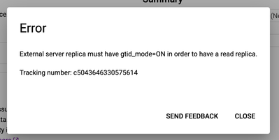

CloudSQL introduces a restriction whereby replicas cannot be created inside CloudSQL if running in GTID_MODE=OFF mode. I understand why Google have added this restriction, as they could not be as flexible with creating replicas/promotion/failover if they permitted anonymous transactions inside CloudSQL.
gtid_mode_replication.pngHowever, in MySQL 8.0 a new feature ASSIGN_GTIDS_TO_ANONYMOUS_TRANSACTIONS was added. This allows a MySQL instance to replicate from anonymous transactions and convert these into GTID transactions.

Your strategy for migrating a legacy MariaDB database to CloudSQL MySQL 8.0, utilizing an intermediary MySQL 5.7 database, presents a potential workaround to the GTID incompatibility challenge between MariaDB and MySQL. The issue you've encountered with CloudSQL's requirement for GTID_MODE to be enabled for creating replicas is a known limitation.
The introduction of the ASSIGN_GTIDS_TO_ANONYMOUS_TRANSACTIONS feature in MySQL 8.0 offers a promising avenue to overcome this hurdle. This feature enables replication from sources without GTID support to replicas that utilize GTIDs, potentially broadening CloudSQL's support for migrations from legacy databases like yours.
However, CloudSQL does not currently support ASSIGN_GTIDS_TO_ANONYMOUS_TRANSACTIONS or the operation in GTID_MODE=ON_PERMISSIVE for these specific scenarios. CloudSQL's architecture aims to simplify and secure MySQL configurations by abstracting them from the user, streamlining operations. While this design philosophy supports a wide array of use cases, it may limit the flexibility needed for more complex migration scenarios like the one you are facing.
