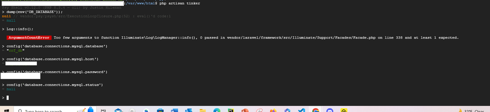

I was doing some debugging and I notice something
on the compute engine i  added the following line of code in the controller that manages my login
$dbConnection = Config::get('database.default');
$dbConfig = config("database.connections.$dbConnection");
dd($dbConfig);
and I get this
array:13 [ // app/Http/Controllers/AuthManager.php:25
  "driver" => "mysql"
  "url" => null
  "host" => "localhost"
  "port" => "3306"
  "password" => "specialpassword"
  "unix_socket" => ""
  "charset" => "utf8mb4"
  "collation" => "utf8mb4_unicode_ci"
  "prefix" => ""
  "prefix_indexes" => true
  "strict" => true
  "engine" => null
  "options" => []]
notice we did not see database name or username
but when i test the same code on the localhost I see the username and database name listed . so this is can conclude that the database is not being linked properly but the password and all other parameters are correct in the .env file

I recently fixed this isssue now i see the username and database name
i tried this line fo code : dump(env('DB_DATABASE'))  i get null in response

here is a pic
The error message you're encountering when attempting to use Log::info(); in Laravel's Tinker is due to calling the info method without any arguments. The Log::info() method expects at least one argument: the message you want to log. This is why you're seeing the "Too few arguments to function" error.
Regarding the env("DB DATABASE") returning null, it seems there's a typo in your command. Instead of a space, you should use an underscore (_) to match the environment variable name as defined in your .env file. So, it should be env("DB_DATABASE").
Here is how to address both issues:
Correcting the Log::info() Usage
To use Log::info() correctly, you need to pass a message to it. Here's an example:
Log::info('This is a log message.');
This will log the message "This is a log message." to your default log channel, which is typically defined in your config/logging.php file.
Correcting the env() Usage
Make sure you're using the correct environment variable name with underscores instead of spaces. For example:
dump(env("DB_DATABASE"));
This should return the name of your database as defined in your .env file, assuming that your configuration cache isn't causing issues (as mentioned in previous responses, env() calls will return null for any variable if the configuration is cached).
Additional Notes
  • Checking Database Configuration: Your use of config('database.connections.mysql.database') correctly returned the database name ("crf_db"), indicating that your Laravel application is successfully reading the database configuration from your config/database.php file, which in turn reads from the .env file or cached configuration.
  • Typo in config() Calls: Be cautious of typos in your config() calls (e.g., config('database.connectons.mysql. database') seems to have a space before database and misspells connections as connectons). Typos can lead to unexpected null values because Laravel cannot find the specified configuration value.
  • Undefined Configuration Keys: Attempting to access a configuration value that doesn't exist (like config('database.connections.mysql.status')) will return null because there is no status key in the default database connection configuration array.

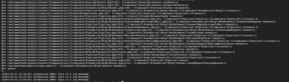

laravel logs
[stacktrace]
#0 /var/www/html/vendor/laravel/framework/src/Illuminate/Foundation/Console/RouteListCommand.php(234): ReflectionClass->__construct()
#1 /var/www/html/vendor/laravel/framework/src/Illuminate/Foundation/Console/RouteListCommand.php(156): Illuminate\\Foundation\\Console\\RouteListCommand->isVendorRoute()
#2 /var/www/html/vendor/laravel/framework/src/Illuminate/Foundation/Console/RouteListCommand.php(125): Illuminate\\Foundation\\Console\\RouteListCommand->getRouteInformation()
#3 [internal function]: Illuminate\\Foundation\\Console\\RouteListCommand->Illuminate\\Foundation\\Console\\{closure}()
#4 /var/www/html/vendor/laravel/framework/src/Illuminate/Collections/Arr.php(560): array_map()
#5 /var/www/html/vendor/laravel/framework/src/Illuminate/Collections/Collection.php(768): Illuminate\\Support\\Arr::map()
#6 /var/www/html/vendor/laravel/framework/src/Illuminate/Foundation/Console/RouteListCommand.php(124): Illuminate\\Support\\Collection->map()
#7 /var/www/html/vendor/laravel/framework/src/Illuminate/Foundation/Console/RouteListCommand.php(110): Illuminate\\Foundation\\Console\\RouteListCommand->getRoutes()
#8 /var/www/html/vendor/laravel/framework/src/Illuminate/Container/BoundMethod.php(36): Illuminate\\Foundation\\Console\\RouteListCommand->handle()
#9 /var/www/html/vendor/laravel/framework/src/Illuminate/Container/Util.php(41): Illuminate\\Container\\BoundMethod::Illuminate\\Container\\{closure}()
#10 /var/www/html/vendor/laravel/framework/src/Illuminate/Container/BoundMethod.php(93): Illuminate\\Container\\Util::unwrapIfClosure()
#11 /var/www/html/vendor/laravel/framework/src/Illuminate/Container/BoundMethod.php(35): Illuminate\\Container\\BoundMethod::callBoundMethod()
#12 /var/www/html/vendor/laravel/framework/src/Illuminate/Container/Container.php(661): Illuminate\\Container\\BoundMethod::call()
#13 /var/www/html/vendor/laravel/framework/src/Illuminate/Console/Command.php(183): Illuminate\\Container\\Container->call()
#14 /var/www/html/vendor/symfony/console/Command/Command.php(326): Illuminate\\Console\\Command->execute()
#15 /var/www/html/vendor/laravel/framework/src/Illuminate/Console/Command.php(152): Symfony\\Component\\Console\\Command\\Command->run()
#16 /var/www/html/vendor/symfony/console/Application.php(1078): Illuminate\\Console\\Command->run()
#17 /var/www/html/vendor/symfony/console/Application.php(324): Symfony\\Component\\Console\\Application->doRunCommand()
#18 /var/www/html/vendor/symfony/console/Application.php(175): Symfony\\Component\\Console\\Application->doRun()
#19 /var/www/html/vendor/laravel/framework/src/Illuminate/Console/Application.php(102): Symfony\\Component\\Console\\Application->run()
#20 /var/www/html/vendor/laravel/framework/src/Illuminate/Foundation/Console/Kernel.php(155): Illuminate\\Console\\Application->run()
#21 /var/www/html/artisan(35): Illuminate\\Foundation\\Console\\Kernel->handle()
#22 {main}
