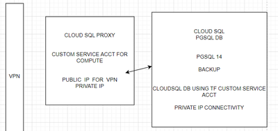

Hi Team,
Facing issue while connecting to OnPrem VPN to GCP Cloud SQL. Cloud SQL PostgreSQL  instance having both Pubilc IP and Private IP enabled.
Enabled private service access and private path connectivity on cloud sql instance. created a VPN Gateway and VPN Tunnel in Cloud to connect OnPrem.
I am able to connect on Public IP from my On Prem Machine however not able to connect on my Private IP.
 Any one, suggest any further network/ DB related changes I have to do.
