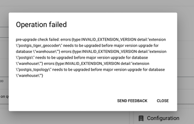

I'm trying to upgrade my Cloud SQL instance running Postgres version 9.6 to 15 and I got the below error.
I then looked around the docs to upgrade the postgis version and found this link. It says
"Note: If you've enabled the PostGIS extension, then you can't upgrade to PostgreSQL 15. Remove the extension, perform the upgrade, and then reinstall the extension."
So, I've tried deleting the extension to see if that works, and it results with the below error
