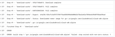

I am getting an error related to the cloud sdk image in cloud build. The same script works on 2 other different projects (different application env dev, staging). I am not sure why this error occurs and fails the build pipeline.  Including a screenshot and error for reference.
ERROR: build step 1 "gcr.io/google.com/cloudsdktool/cloud-sdk:alpine" failed: step exited with non-zero status: 1.
1 4 843

I am facing same issue @chamath_eka have you been able to solve it?. If yes please share. Thank
Nope @Ibrahim_Saibu , still i am facing the issue.
@Ibrahim_Saibu I was able to fix it, the issue was with another script in that same step defined in the cloudbuild.yaml. So i suggest you to have a lookinto what happens after the pulling the image.
