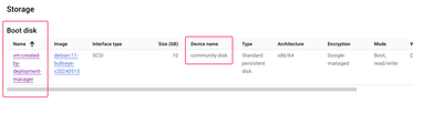

It works. However, it changing name "device name"
You can use this name to reference the device for mounting, resizing, and so on, from within the instance. By default, the device name is autogenerated based on the disk name. You can also choose to enter a custom name."
resources:
- name: vm-created-by-deployment-manager
  type: compute.v1.instance
  properties:
    zone: us-central1-a
    machineType: zones/us-central1-a/machineTypes/n1-standard-1
    disks:
    - deviceName: community-disk
      type: PERSISTENT
      boot: true
      autoDelete: true
      initializeParams:
        sourceImage: projects/debian-cloud/global/images/family/debian-11
    networkInterfaces:
    - network: global/networks/default
Screenshot taken from VM settings.

so there is not a way to change 'Name' and not 'Device name' ?
My problem is since the disk 'Name' field always takes the instance's name as its name, I can not recreate an instance with the same name, despite changing the old instance's name first.
example for more clarity:
t1 -> creating instance test1 | disk name will be test1
t2 -> changing name of t1 time instance test1 to test2, then creating new instance test1 | its disk name will also be test1, so stack creation will fail telling that disk named 'test1' already exists.
I don't understand why GCP is over-complicating things.
