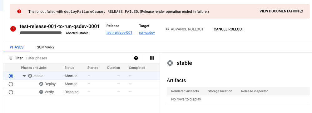

There is no release, it fails at rendering with the message "The rollout failed with deployFailureCause: RELEASE_FAILED(Release render operation ended in failure.)" and there is no rows to display  under Artifacts tab / render logs. The deploy phase is aborted.
Hi @sanderbogdan I tried again with a fresh project and it worked. Once i try it in my current project which contains other resources, it doesn't work. I can't find what is the problem. The permissions are set and the APIs are enabled.
This is what it looks like : Bildschirmfoto 2024-04-04 um 23.09.33.png
That is great to hear (and also strange)! I am unclear why a render failure would occur due to a project configuration setting, the only idea I could imagine is that may have been some permission issue(s) on the specified or default SA performing the render operation.
