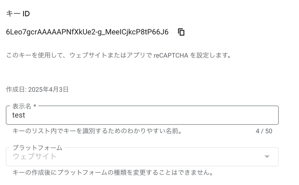

I found that it was failing in updateConfig.
https://cloud.google.com/identity-platform/docs/reference/rest/v2/projects/updateConfig?hl=ja
400
"recaptchaKeys": [
"key": "6Leo7gcrAAAAAPNfXkUe2-g_MeeICjkcP8tP66J6",
"type": "WEB"
200
"recaptchaKeys": [
"type": "CLIENT_TYPE_UNSPECIFIED"
