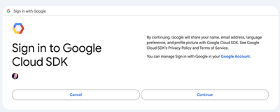

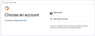

Why do I have to complete 3 Cloud SDK sign-in steps every time I run "gcloud auth login"?
I don't have to do this for any other app I add to my account. Am I doing something wrong?

No this happens every time I run "gcloud auth login" in the terminal. I've asked around to see if it has something to do without we configured our enterprise account, but when I tried it on my personal Google Cloud account on my personal machine, I ran into the same issue.
