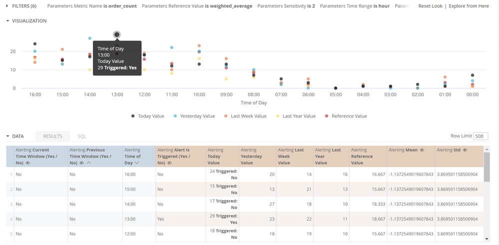

Using stats, LookML and scheduling capabilities, we are able to track and alert on KPIs in near real time.

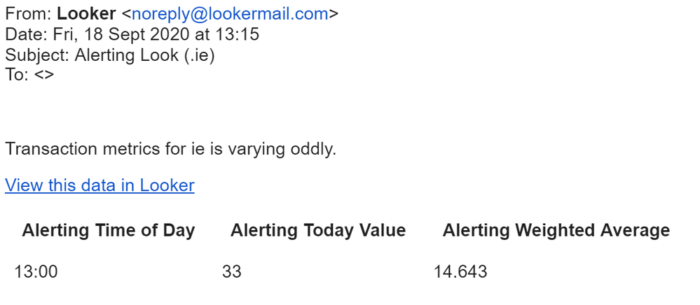

Anomalies detected in KPIs will trigger alerts, which will be sent to users using Looker scheduling capabilities.
The thresholds for alerts is dynamic, with different approaches to defining what an “anomaly” is.
This block has weighted averages set up as a default to detect anomalies. But you can also provide a linear regression layer, or more advanced modelling (e.g. using BQML) should you wish. See “how to add more anomaly detection methods”

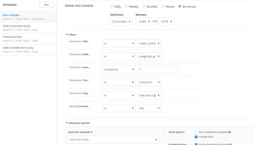

– A business user can go to the alerting explore to set up an alert.
– They must select at least one measure or dimension.
– They can then save as a look and schedule it.
– In the schedule menu, this is where they should set up their filters. If they did this in the explore when they saved as a look, they should come through to the schedule.
– All the filters have defaults set, but can be tweaked as required.
– The filter Trigger Flag filter is set to see only triggered values as a default. So only rows of data that has been triggered will return in the query
– The current Time Window or previous time window should be set to YES (not both!). This will ensure only one row of data is returned, rather than all historical alerts.
– If testing or looking back at historical alerts in the explore set both to NO
– Optional filters including changing sensitivity or weights for calculating the reference value.
– Ensure in the schedule under advanced options you set Send this schedule if there are results
– Ensure Deliver this schedule is set to the same timeframe as the Parameters Time Frame
Users will be able to manage all their alerting from this schedule menu.

Example of the email alert:

Example of the alert metrics:
Example of the alert toggles:
