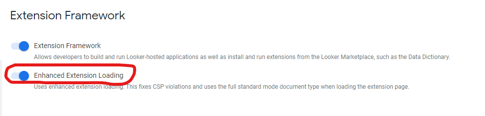

I have asked for technical support but so far the only solution to this problem is to turn off Enhanced Extension Loading, and no further support for me since my codes are “customized”. I hope the Looker team could look into this soon.
