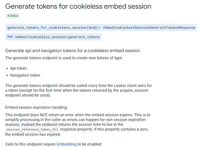

Hi, a refresh token message will be sent to the embedded client.  Check the information here:
I tested that endpoint (PUT /embed/cookieless_session/generate_tokens), it doesn't refresh the session_token_reference's TTL. It only re-generates the navigation_token and the api_token.

Hi @flotor , I'm having some issues with https://cloud.google.com/looker/docs/cookieless-embed#generating_new_tokens api. Im unable to generate new token even if my session ref ttl is set to 8 hrs.
Are you able to complete this cookieless embedding flow?
