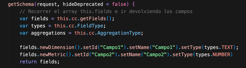

I made a simple test, and the metric is considered a dimension even in this simple case.
I don't know how to get dimensions and metrics separated.
I also tested just lower case characters.
Any idea?
