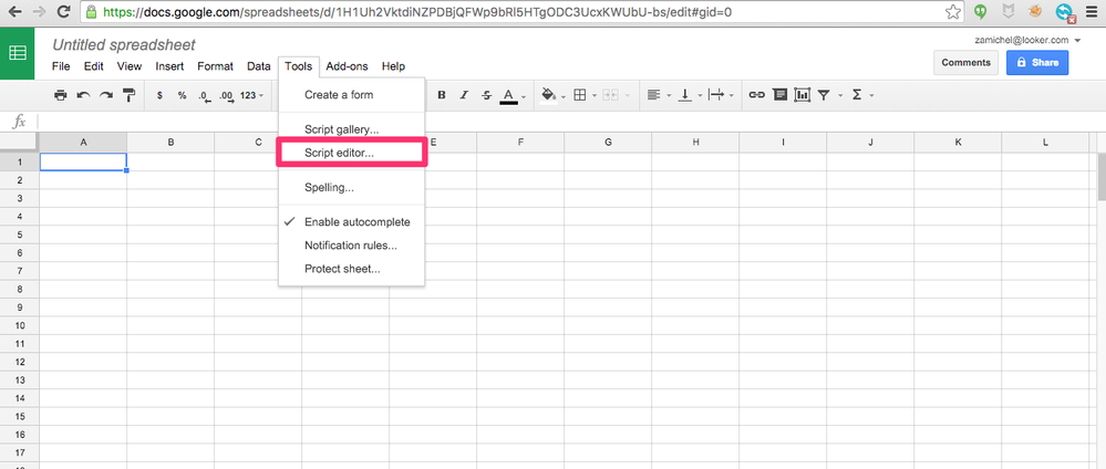

In order to use the function you’ll need to add the script at the end of this post to the desired sheets’ scripts. Here are the steps required to get the script installed:
  1. Make sure the look is public.
  2. Head to Tools > Script Editor from the top section of the sheet.
  3. Paste the code from the script at the end of this post into the script editor and save - you may give it whatever name you’d like. Close the script editor and refresh the Google Sheet.
  4. Use the function =lookerFetchData(url) within the cell where you’d like the table to start replacing url within the parenthesis with either of the highlighted public url options below, wrapped in double quotes.
